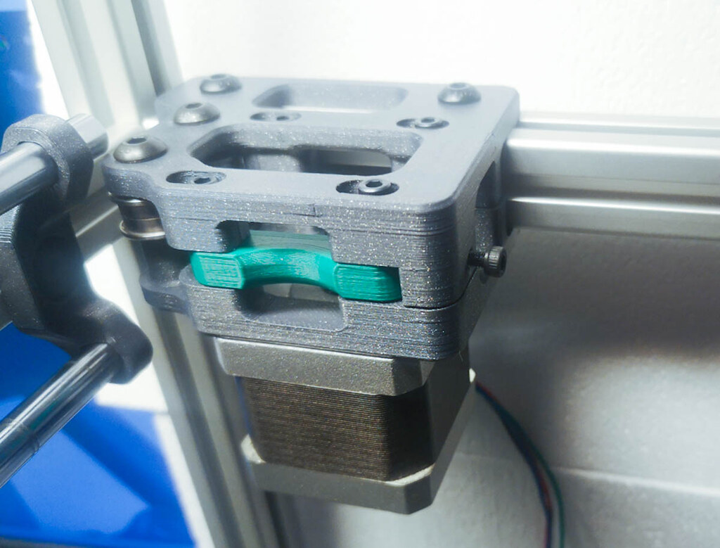

The build is going pretty well, two evenings of work and it's pretty much together. Started off with the frame and then the z-axis.
Next was the y-axis and then the x-axis. I have to say that the motion system feels a lot stiffer then I was expecting.

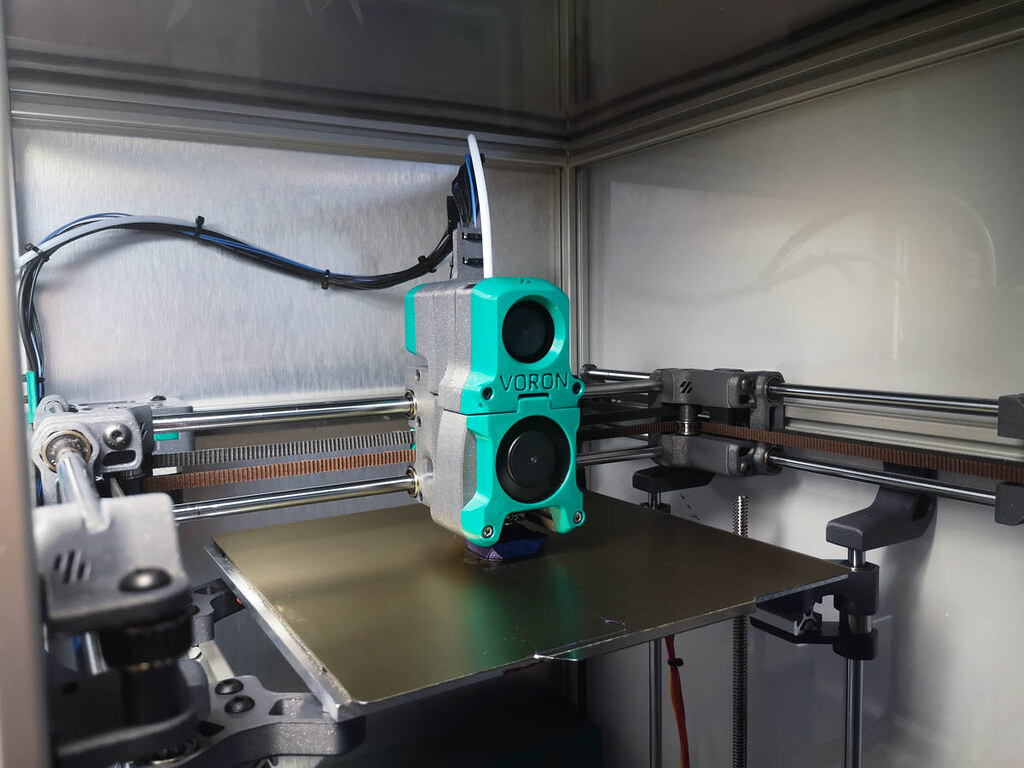

And finally adding the toolhead. To start with I'm using the Afterburner with a V6 and bowden.

Now I built this mainly to get a Legacy serial to go with all the other ones, and I had a lot of the parts so it didn't cost too much. The plan was to just build it and put it in storage as a backup since I don't have space for more printers at the moment. But this printed way better then I expected, it was a long time ago I had printers with rods and this is a lot stiffer then any printer with rods I've had before. The only thing that I felt kept it back was the bowden and the pressure advance. So I actually swapped to a clockwork extruder and retuned input shaper and pressure advance and this thing prints really nice. So I'll keep this here and put one of the SW in storage as a spare.
So this is now Voron Legacy 61
