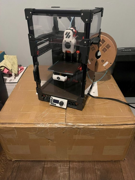

Having finished my first Voron (build log here), it seems I have caught the bug! The main goal of that printer was to use the 0.2r1 to print all parts for a 2.4r2. The main goal of this printer is to aim for Serial #7000!
I researched for a few days, self-source vs kits and decided that a kit would be the best value for my own needs. Even adding on the options I wanted to a kit was cheaper than self-source for me. Although I really loved my Formbot 0.2r1 kit, I settled with a fully comprehensive kit from Magic Phoenix (MPX) as it ticked a few more boxes 1) Canbus and TAP included - plus all the boards and hardware, 2) Cheaper - living in a post-Brexit UK meant a huge bill for import tax. MPX had an option of slow shipping with taxes included. 3) Support - before I bought the kit, I was in regular contact with the owner on the official Voron Discord and their Discord to make sure my needs were met. I already had a 120mm V0.2, a 225mm CR6-SE so 350mm was the right size for me.
[V0.2r1 on top of shipping box]

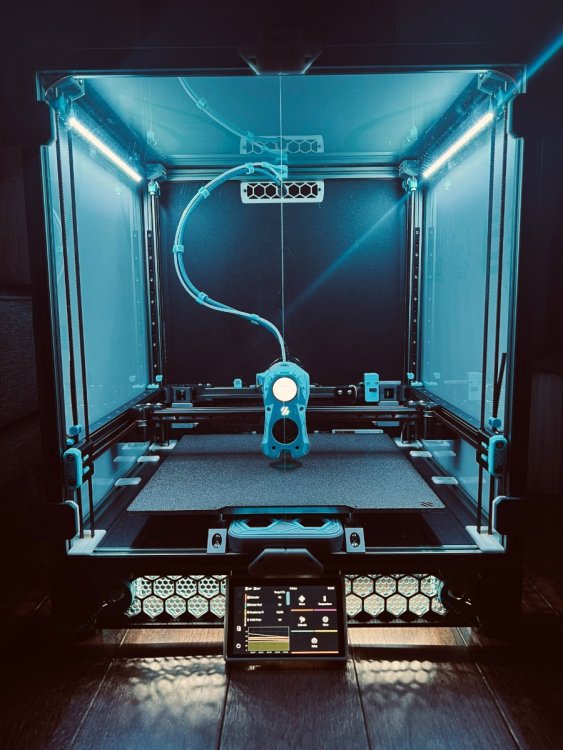

Job done.

I'm blown away at how good this looks. I got the green light to start putting together my build list and will be using yours for inspiration. Amazing job.

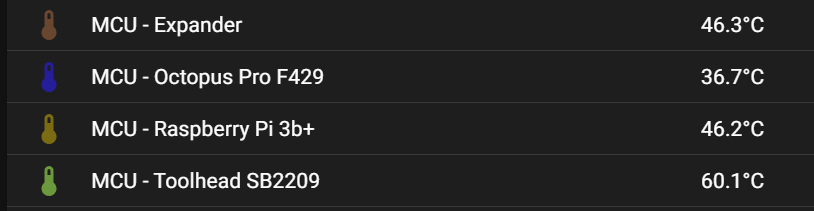

I added Winsinn 12V Sleeve Fans on both sides of the bay (in and out). Whilst the MPX kit came with GDSTime fans, I found them too loud and bulky (20mm vs 15mm). These are triggered in Klipper as controller-fans (i.e. on only when steppers/heaters are active), running 100% speed but on the 5V rail silently.
A 40mm RGB fan was used to cool the RPi 3B+ (a necessity, with the RPi running at 70-80C without) and a 92mm 12V fan (silently running on 5V) for the Octopus Pro.
