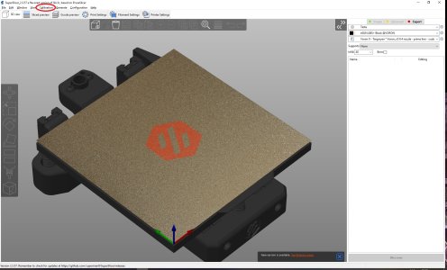

SuperSlicer have a menu option for Calibration, which includes retraction settings. You should run these on you own printer, the default profile is just a foundation from where to build your settings.
Remind me where you got the 3d model of the bed and texture for the V0 profile. I used to have this and did the "cleaning" of my hard drive this weekend and accidentally deleted my files and I don't recall where I got them.
This specific one on the screenshot I got from Discord a long time ago, but there is other (slightly different) on the Github repo, as linked by claudermilk.
