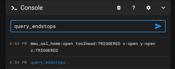

So I'm going to ask the question again, with the clarification that I'm not asking what's *really* hooked up, I'm just asking what the output says when you run the command: what does query_endstops say?
What I get is a statement "Must home axis first: 1.000 0.000 0.000 [100.000]" When I click the X Axis movement button or enter it in console. I get the same response for each Axis. Is that what you wanted to know?
Also if it helps. The Z axis does not hold position. It just slowly falls to the bed. The steppers are all getting signal. I know that because they will buzz and rotate back and forth a few steps.
that can't be right. should look kinda like this (my machine has an MMU, so it's got some extra endstops)
