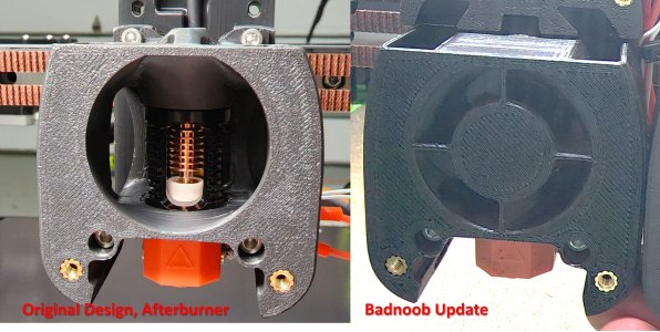

I have not had any issues with PLA. However, PETG showed an issue I haven't seen with other filaments. I experienced my first clog with this hotend yesterday using PETG. I believe the characteristics of PETG contribute to the issue. Researching this I believe from what others have found, the design of the stock hotend cooling system is not designed for the Dragon style of heat sink. It allows air to bypass the heat sink and contributing to heat creep, the primary cause of the clog.
It is a fairly easy fix to correct. Badnoob has an updated fan flow area that fixes the airflow to heat sink issue. You can find it HERE. Once this is in place the issue is gone. This is a comparison photo of the two.

Reading the info that Badnoob has on this Mod, he modeled it after the Stealth type air inlet that focuses the air flow better over the heat sink. Since making the switch I have had no more issues, even using the same parameters. I purposely tried it with the same print and filament I had the failure with. It printed with no issues with this updated fan duct.
Had no issues with dragon SF using s CHT nozzle with ABS, ASA and PLA. In two years including a good bit of that using Afterburner (and I confess part cooling was not the best with PLA, but that's unrelated to the actual hotend), not a single clog, stringing or heat creep. Not saying people reporting issues are wrong, but sometimes it is easy to blame a system when replacing it solves the problem... Thing is you still haven't found what the actual issue with the previous system was.
