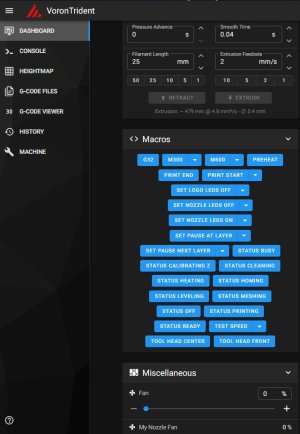

I have an ERCF v.2 already made and want to print in color and that was the idea to build Voron Trident.
So that the light does not affect the print, I only have white LEDs installed in the box, which are on or off.
I only want to manage the three neopixels that are embedded in the head of Stealthburner.
But no matter what I did it either had no effect or Klipper didn't like something and gave an errors.
The interesting thing is that all the manually controlled macros found in the mainsail dashboard work flawlessly
and the LEDs are switched in the specified combinations.
I hope the config files of the printer and LEDs will be useful, as the comments have been translated into BG.

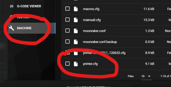

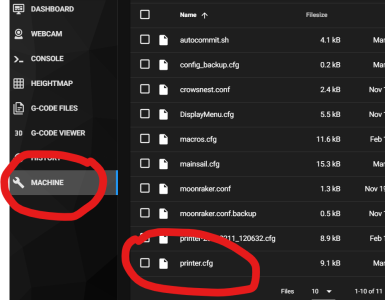

See below for where the printer.cfg file can be found.
Example klipper files:
For my 1st voron / klipper machine, I found the default printer.cfg that matched my main board and machine, then tweaked the file as I stepped through the "Voron Startup Guide"
Hi Sandman50,
Thanks for the info, but maybe you didn't understand me correctly or what the problem was.
I've gone through all the Voron Design guides setting up the printer step by step.
The printer now works and prints perfectly, for which I am grateful to its creators.
The only thing I could not deal with was the configuration of the three neopixel diodes that are installed in the
the head of the Stealthburner so that the combination of the light of these diodes corresponds to the actions it performs
the printer at a given time.
I'm trying to use this config file /stealthburner_leds/ but I don't know where, how and what to type,in printer.cfg so Clipper can read and manage them.
I don't have a TFT screen installed and the printer is controlled by a computer via WIFI. When I manually use the blue ones
buttons in the "Macros" section of the screen, the lights are controlled, but I wish Klipper would take over that function :)

George, I think the problem is we are not understanding what you mean when you say you cannot write in the Printer.cfg file.
As Sandman50 pointed out, click on Machine, then the printer.cfg file.
This is where you put your configuration needed. By clicking on the printer.cfg file it opens in an online text editor that allows you to make changes. Make sure you click on the save and restart in the upper right hand corner after you make the changes.
Upload the "stealthburner_leds.cfg" cfg to your printer.
Then, edit this line
[neopixel sb_leds]
pin: 'enter_your_led_data_pin_name'
to have the pin number for the header you connected the leds.
Then add:
[include stealthburner_leds.cfg]
to the main printer.cfg file (normally at the top)
Then "save and restart"
