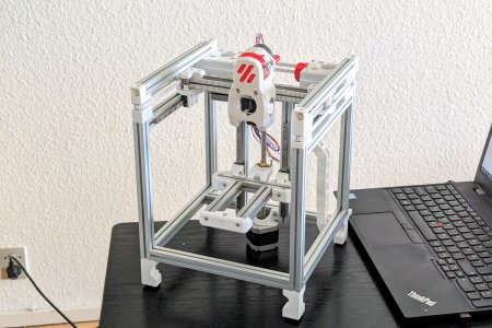

oh, and by the way, the reason that i gave this (soon to be) voron the nickname "the egg" is because, i always thought that the voron v0.1 looked like an egg, and this is going to white, so, well, i thought it was fitting

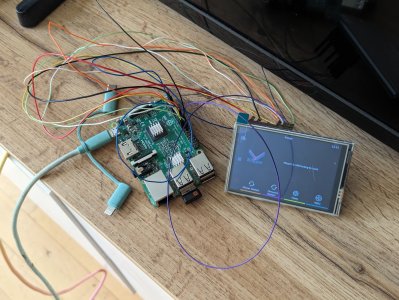

I almost forgot it, i also managed to install Klipper on my Raspberry Pi, and connected the Elegoo TFT touchscreen via the GPIO pins, the colours are dim, the viewing angles are bad, no to speak of the abselutly high refresh rate, of just 4Hz, but it was cheap, 5£ on sale from amazon (DE), and it does the job, but i should properbly have bought the Waveshare instead, but thats future me´s problem to deal with.

FINALY! it´s alive :D and it even managed to print the first test print without any trouble, the only thing there is left, is to finalise the enclorsure thats going on the back, where all the electronics can reside, kinda like a mini PLC cabinet (and clean up some of the wiring)
