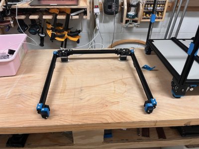

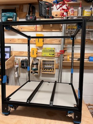

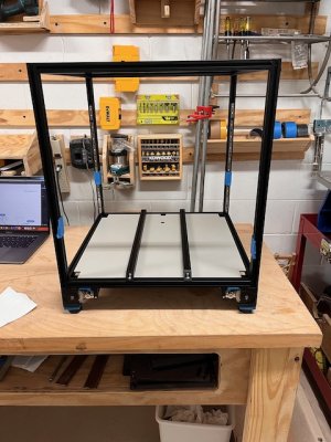

Built the frame:

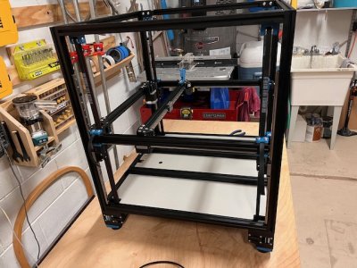

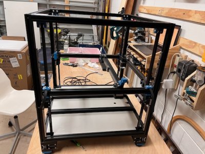

Built the Gantry: and added it to the frame:
Installed the bed:
We had a few issues with the z Drives where the pulleys didn't want to slide onto the shafted but we were able to get around that by putting the shafts in the freezer for the night. The pulleys and bearings slide on nicely the next morning.
The kit didn't have the parts for the Z endstop so we went ahead and installed TAP for the X carriage. We had some confusion when going through the instruction for the assembly until I found R8_errata. This cleared the confusion.
