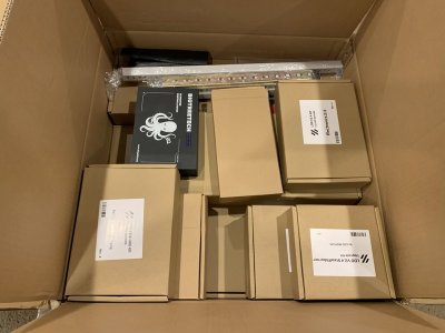

Context/Disclaimers: I won the LDO 2.4/300mm kit that will be central to this build in a holiday giveaway. I did not receive it in exchange for any promotion, review, or anything other than the fact that my name came up on a random number generator. But I do want to make it clear that I did not pay for it. The folks at LDO are fantastic contributors to/collaborators with the Voron community, and I can’t thank them enough for providing great prizes to the community for the holidays! (Specifically @JasonfromLDO is amazing to deal with, and I want to thank him publicly for all that he does for the Voron community!) But they did NOT provide the kit in exchange for promotion or review.
This is NOT a retail kit, so it may not be representative of what you would buy from a reseller. Lots of resellers customize their kits, so be sure to check with them about specifics prior to assuming that this kit is representative of a specific kit that you are considering buying.

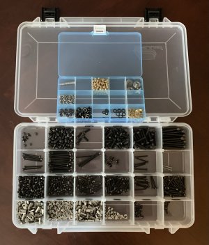

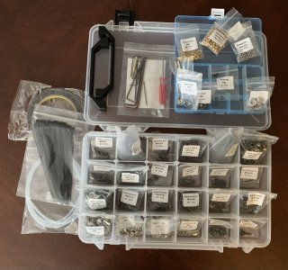

Before anything else, let’s get organized! The best thing I ever did for helping my printer builds run smoothly was to make a screw bin. I’ve already got one with my stainless hardware, but LDO uses hardware with a black coating, so I don’t want to mix those bins. I’m not entirely sure what the coating is, but it’s NOT black oxide. The hardware is high quality. This is nowhere more obvious than in the brass 5mm spacers. They are much better than the stamped washers that I’ve seen in some kits. As long as they are the right thickness, they will work, but this attention to detail in a “minor” part is indicative of the quality of the kit top to bottom.

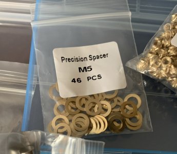

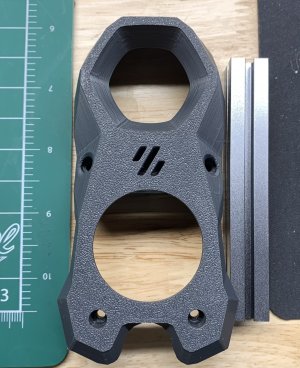

This brings up my only real gripe with the LDO kits: I think that they are too expensive. I, personally, would not have splurged on machined brass spacers, for example (but man, are they well made!--see picture). I don’t think that they provide a good return on investment in terms of performance. There are other, similarly overly nice parts throughout the kit that I think are overkill for their job. And to be fair, that's exactly what LDO is trying to do with this kit! They aren’t trying to compete with the cheap kits. They are trying to provide a no-compromises, extremely high quality kit for folks who want the best parts out of the box. They are selling the Lexus experience when others are selling Toyotas. and even though I, personally, am not a Lexus guy, there is no denying that the premium experience comes with a lot of nice perks.

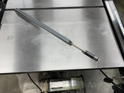

A few other things to note: the tools that come with the kit are just about all that you will need to build the printer. You will need scissors and a soldering iron, but I think that’s about it in terms of extra tools. I’ll be using my own tools because nice handles are nice, but it is good that LDO includes a solid tool selection. The heat set insert tool is especially nice if you don’t already have one. A generous roll of VHB tape, appropriately sized zip ties, and some Bowden tubing round out this box. Lots of good stuff.

Just like that, screws and hardware have been de-trashed. Everything got labels in the bins. This is well worth the extra time it takes for the sake of organization and not constantly sorting through bags. Plus, it lets you easily see what screws you are missing when it’s time to order spares!

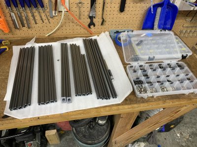

Frame parts all sorted and ready for assembly.

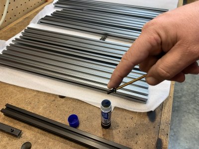

I always throw on thread locker to frame screws just for good measure. I really like the glue stick style thread locker, but obviously other types work as well. Do NOT use the permanent thread locker! You probably want the option to take things apart later without having to use a blow torch.

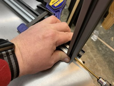

So, this is the WRONG way to assemble the frame. I was trying to get a good picture of how to clamp a backer piece of extrusion to help with alignment, and had the vertical extrusion in the air. It didn’t make a good connection because it was a little unstable. Both pieces should be flat when you are assembling. If you are curious, I’m using my table saw as a flat reference surface. It’s ground extremely flat, and after my granite plates, it’s the flattest surface that I have in my shop.

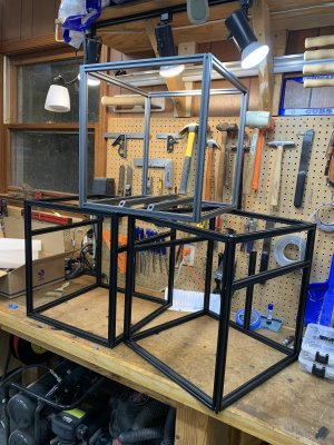

I mentioned earlier that I was building two Tridents while building this 2.4. Here are all three frames—knocked them all out today before taking a break until the new year. The printed parts for one of the tridents are done, and the second batch is about half way done. But I still haven‘t even started printing parts for the 2.4! I’ll start printing them in about a week or so, but for now, this printer will be in the back burner until at least one of the Tridents is done.809A23E6-AE95-414C-829B-9D9AA325EB91.jpeg
