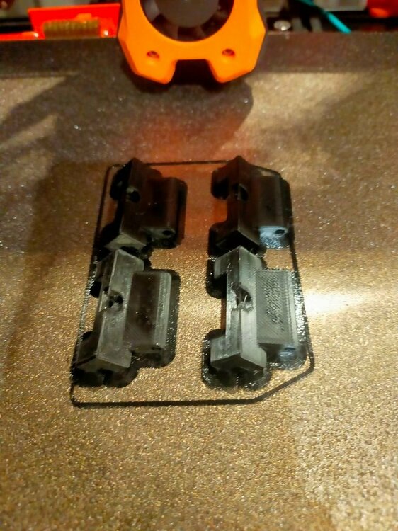

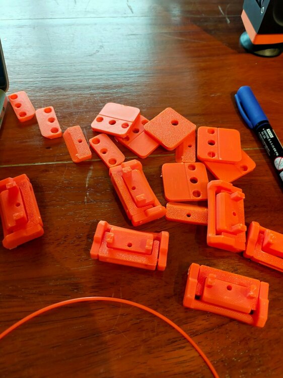

After I put together skirts, re-cable and wire, panel and stuff.
The printer behaves strangely. I also had some octoprint plugins enabled too though.
ie: Arc welder, thermal runaway, better graph, better time lapse, etc.
Just to test the boot time that I had a problem with before. And this time only activate them one by one.
Just to see if it didn't affect the boot time.
1. The print couldn't finish. It prints a few min and stops and moves away just a little mm and hold.
Then klipper alert error like too many requests or something.
I had been scratching my head for hours til I realized it may be the timelapse that caused it.
So I turned it off and now it can finish printing the 1st layer calibration.

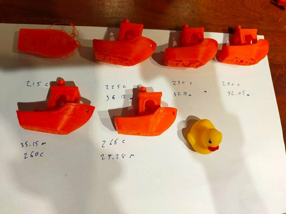

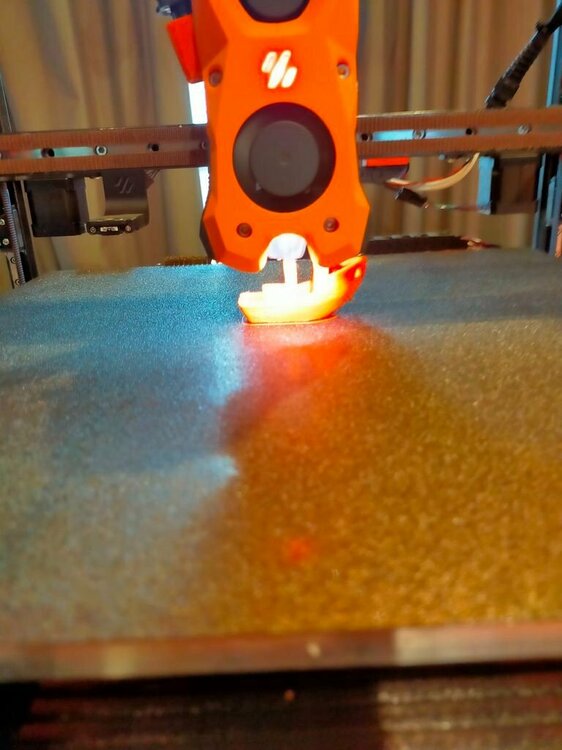

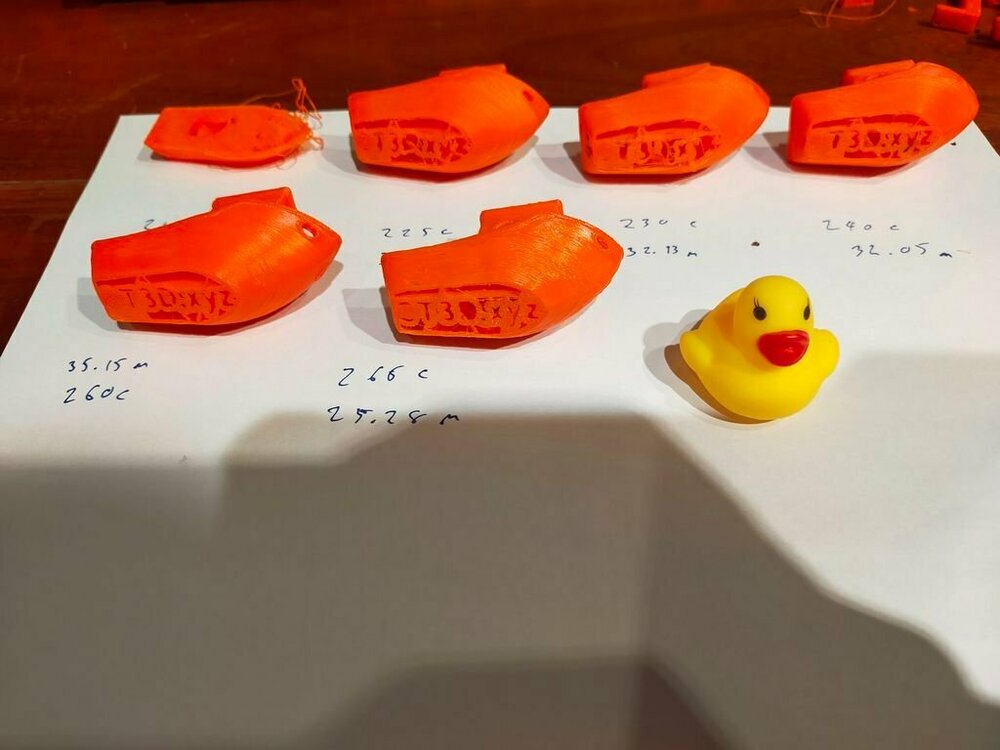

So I decided to go for Benchy!!!
My 1st try with normal temp I use with normal speed. It failed.
Then try 225C I thought It was very fast moving already. But it is still 36 min including heating time.
The print quality was not very good. I really admire those under 10mins and produce better quality.

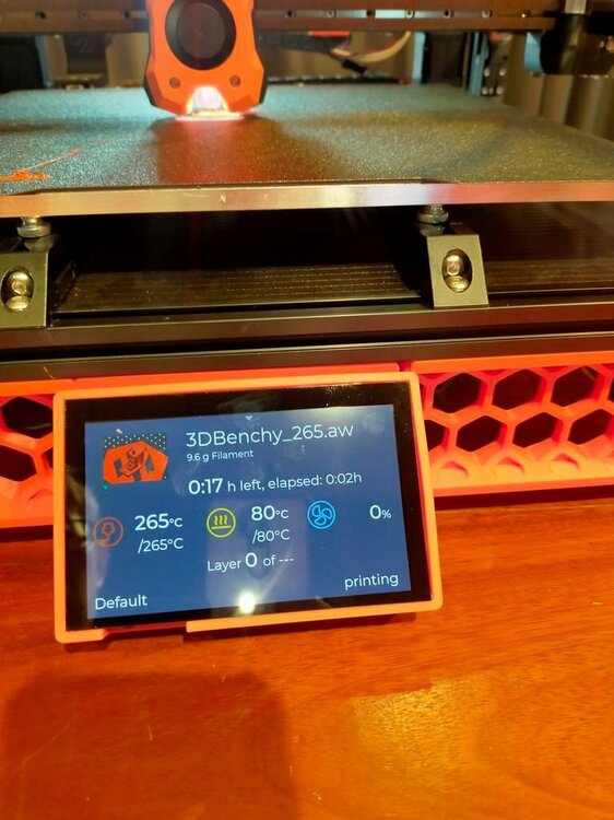

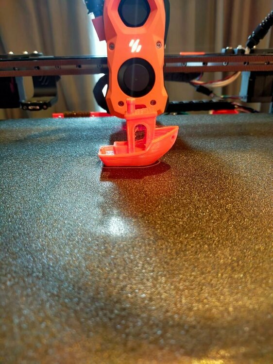

My last try for the day at 265C and crank some speed and acceleration.
And had everything heated up and ready before print.  25+ min.
Hahaha that's fun and my daughter has more toys to play. She was also happy.
