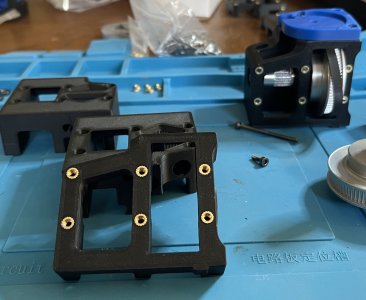

Started putting together the SB, and the hotend (may have already mentioned the hotend).
Built the Clicky-Clack door mod - the kit from West3D is very nice and easy to put together.
I’ve avoided the wiring so far because I’m a little worried about confusing the shit out of myself - in between the manual, the SB manual, the G2 manual, the LDO build notes (which seem to have their own issues with page numbers) and whatever else (I haven’t even gotten to Nitehawk or Beacon yet!) - it seems very easy to lose track of things.

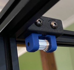

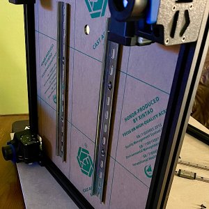

- while the build is still in a somewhat minimal state, recheck frame squareness and belts in advance of X carriage arrival.
