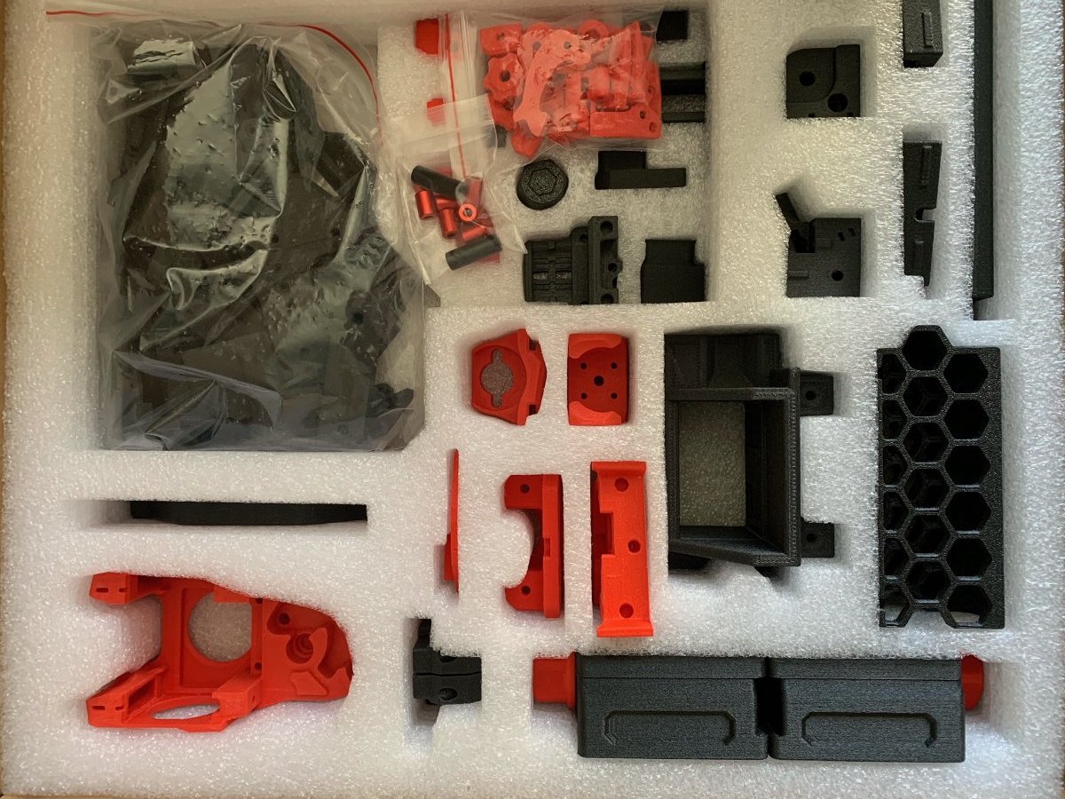

ABS parts come in a separate box with phenomenally good packaging. Each part has it's own customised cut-out.
The quality of the parts themselves was impressive. No warping and uniform adhesion.

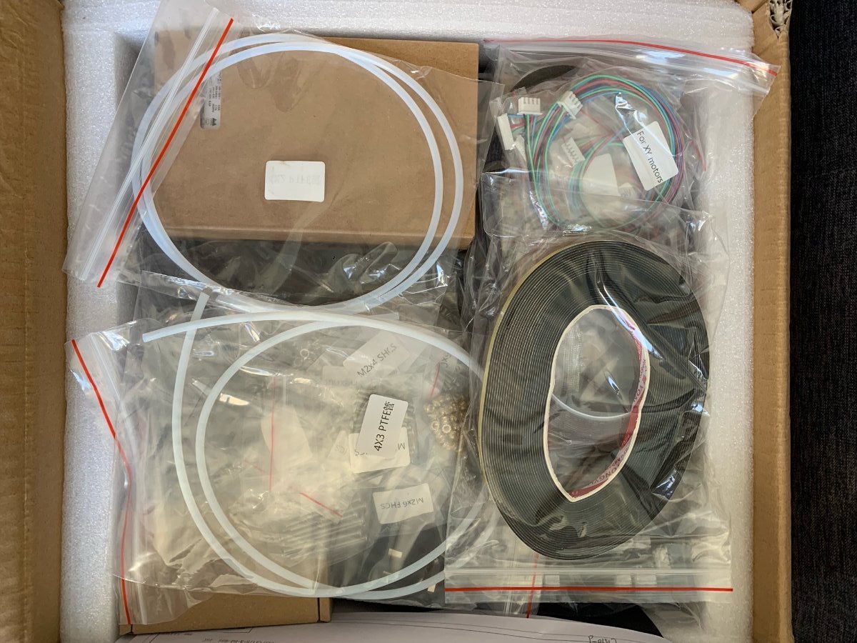

The larger box contained a couple of layers. The top layer comprised of loose bags of fasteners, motion systems and wiring.

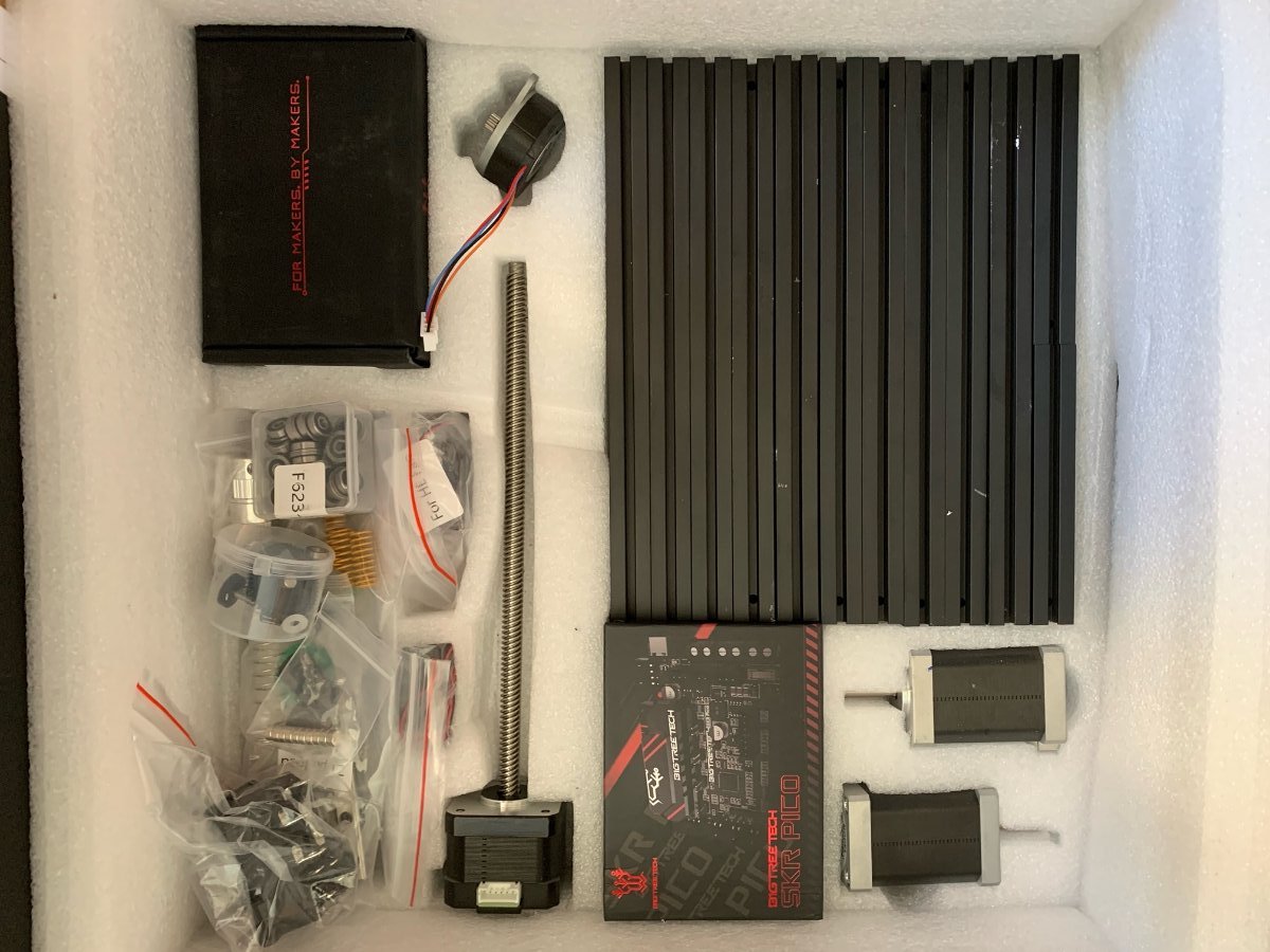

The second lower layer contained customised cut-out sections for the extrusions, motors, electronics. Despite these cut-outs, some of the extrusions managed to free themselves in transit and scratched up. I will try and hide tactically hides these on the build! The 1515 extrusions are anodized after being machined/cut. Whilst the Formbot BOM states "Makerbeam XL", this is not actually the case. The profile is similar to the LDO 1515 extrusions ("D" channel rather than Makerbeam's "T" channel).

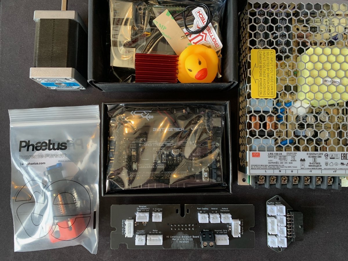

The electronics included in the kit: BTT Klipper Pi (v1.2), BTT SKR Pico (v1.0), genuine Phaetus Dragon SF, Meanwell-branded PSU and Moons steppers. The BMG gears seems quite generic and might be a target for a future upgrade.
Overall I am very happy with the quality of the kit and the USD$60 outlay for all the ABS parts (functional and cosmetic) seemed a good decision. Trying to print ABS in my open-air Creality bedslinger or causing a fire-hazard in a cardboard enclosure would not have been worth the hassle!

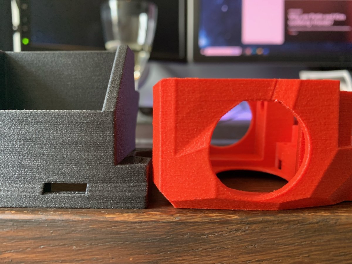

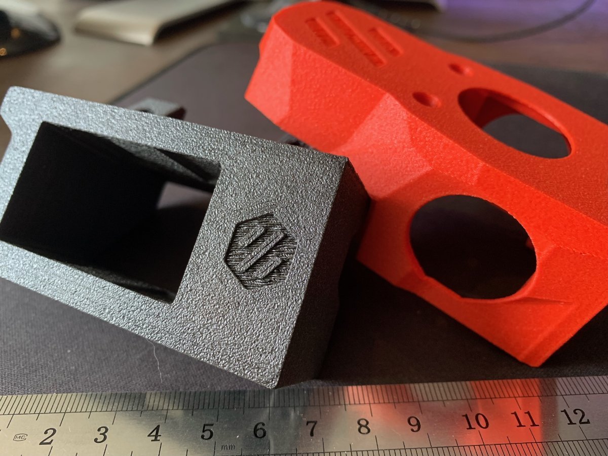

Please let us know how the printed parts work out. Looking at the one photo of the printed parts up close, there are only 3 perimeters and they look wide, seems they were printed with 0.6mm nozzle. This is not per Voron printed parts guide which requires 0.4 mm nozzle and 4 perimeters. Additionally there is no way to tell how much infill there is and how many top and bottom layers, both of which make the parts stronger if they are printed per Voron settings.

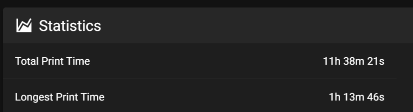

It took a couple of hours to run through Ellis' Tuning Guide, and with that, she was finished and printing the first mod almost perfectly.

Well, that's definitely NOT the Voron spec 40% infill. Looks closer to 20%, and the way the part separated is indicative of poor layer adhesion. That doesn't bode well for the rest of the parts in the kit. I was afraid of that. It would be advisable to seriously consider reprinting all structural parts immediately. With that said, sadly, eSun ABS+ is notorious for having the same issue of poor layer adhesion and premature failure (regardless of printing parameters), so it it's very recommended to use regular ABS/ASA.
Otherwise, this is looking like a great build! Well done!
No that's my failed part, not Formbot's. You are right though, I'd set it at 20% thinking a foot would be fine, albeit with 4 walls. Perhaps I'll do it to 40% but currently have a long list of other mods to sort out :)
