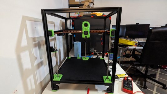

These two items alone in kit form saved me at least CAD100. I'm still waiting on the final 350mm linear rail for the Y axis (arriving today sometime) before I can continue with the build, but here's what I have so far!

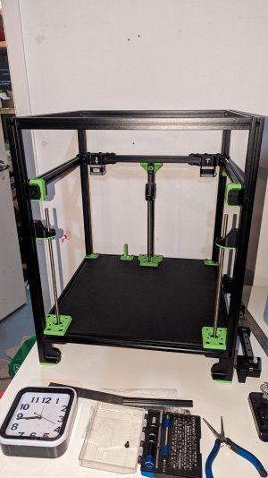

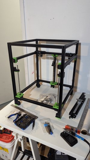

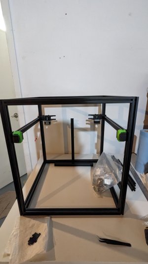

Frame built and idlers and AB drives installed
Finished up with the Z axis

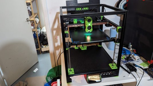

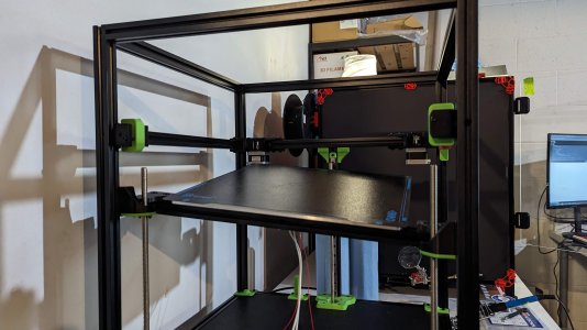

Installed the bottom panel and wire covers
Bed resting in place for now... The ball and socket joints on the Z seem to work as expected
(spring steel plate will be replaced after I'm confident that the nozzle won't dig holes or trenches in the PEI sheet)

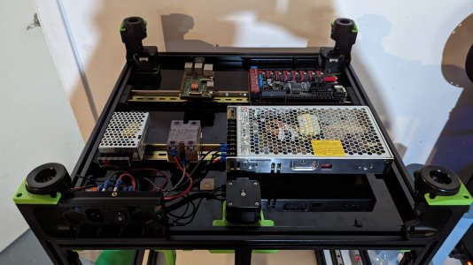

Some electronics and wiring already started (will be tidying up the wiring a bit later)

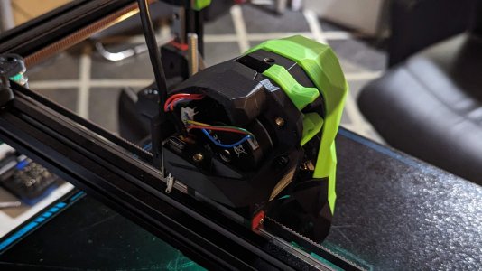

  • Completed the CW2 and Stealthburner assembly
  • Belt routing was fun... but done!
  • Managed to get all of the electronics wired up and as tidy as I'm comfortable with
I had a bit of an issue with the heated bed not warming up, but after about 2 hours of struggling I realized that I had both ends of the wire connected to live! TWO HOURS to find that... and fixed in a few seconds!
I still have to figure out how to use both a CAN HAT as well as a DIP-format display to work on the single GPIO header of the RPi, but that's a project for another day.
PID tuning done on both bed and hotend. Next up is "e-steps" tuning and a test print!
Stealthburner Installed
Wiring of the SB2209 done!
And it looks like everything works as expected!

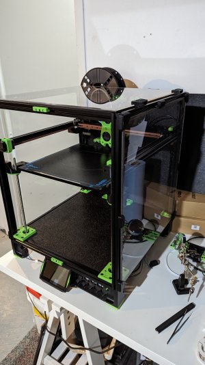

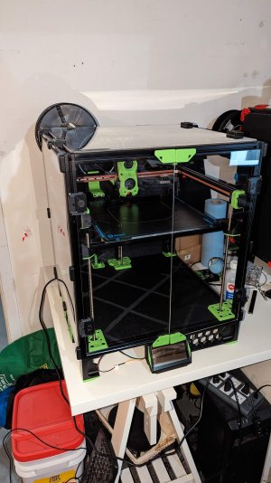

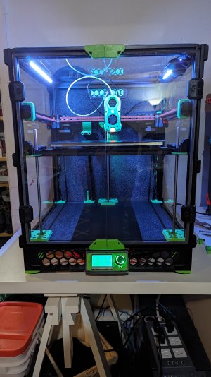

Panel installation started
Doors installed

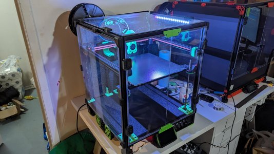

Chamber lights working ("Disco on a stick" on either side of the chamber)
Mini12864 display installed and working, and C270 web cam installed (front right)
