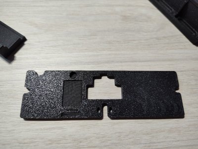

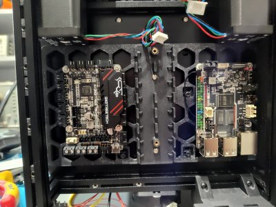

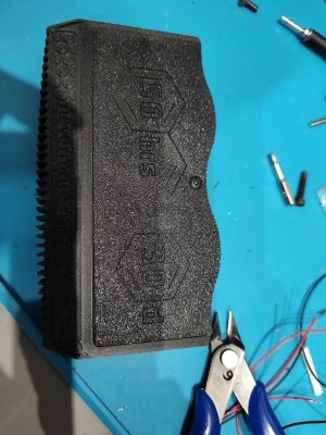

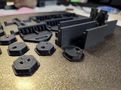

What is planned:
  1. mostly black - printed from Fiberlogy ABS color ONYX
  2. hotend - Rapido 2 plus UHF
  3. control board BTT pico
  4. BTT Pi
  5. display BTT TFT35
  6. carbon gantry
  7. dragon burner
  8. extruder m4
  9. all rails from hiwin
  10. LDO steppers
  11. CAN
  12. kirigamii
Who know what else/more :D

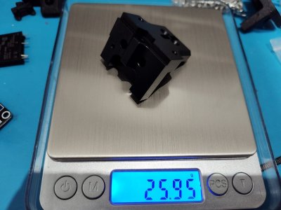

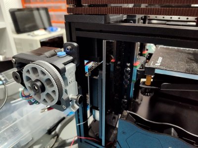

Time to start assembling. Mobus m4 :)

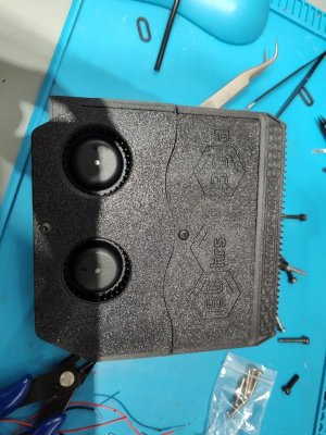

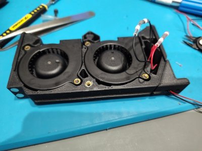

And little more :) I deciade to use MF nano, not nevermore, becouse of size. Also I decide to change hotend to Dragon Ace, becousew it's smaller than Rapido UHF and I can use Dragon Burner instand of Rapid Burner - from my poin of view, Dragon Burner looks much better in v0.

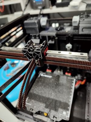

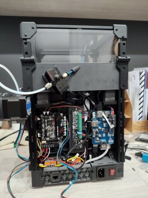

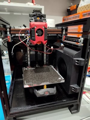

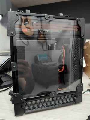

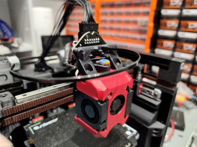

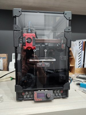

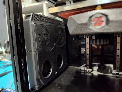

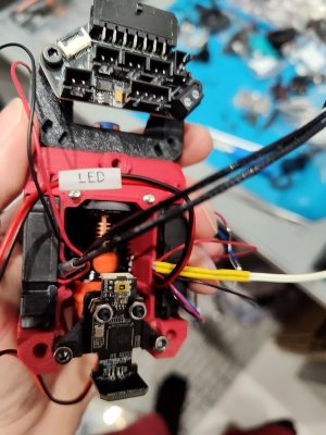

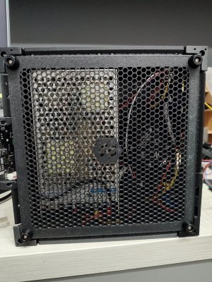

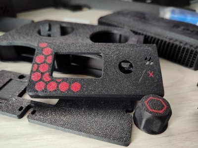

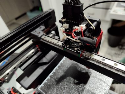

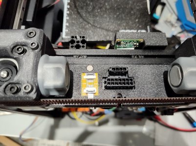

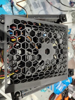

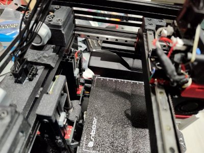

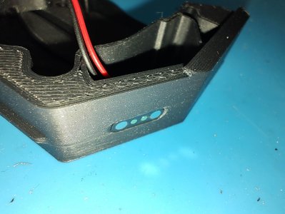

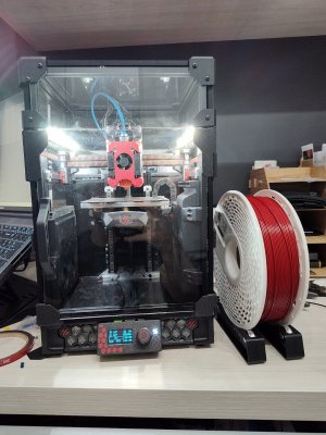

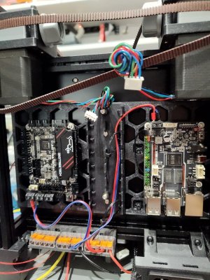

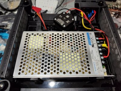

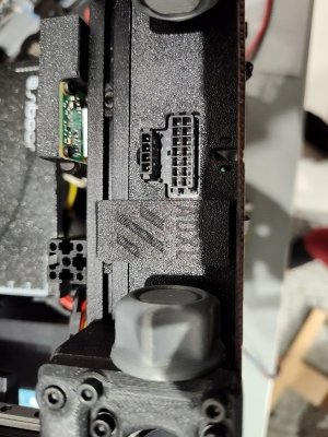

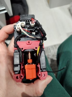

I’m back! After a long break caused by a bunch of different things, I’m returning to the build. A few things will be different:
  • toolhead: Yavoth
  • extruder – Dragon Ace
  • Raspberry Pi 4 instead of the BTT Pi - in the photos it’s still the BTT Pi
  • a simple Voron V0 display instead of the BTT TFT35 — on the Trident I barely use the screen anyway, I control Klipper from my phone or PC
  • LDO Picobilical
  • and probably some overkill in the form of the Cartographer
There will probably be more changes — we’ll see what time brings.

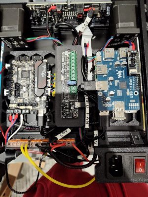

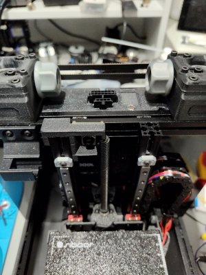

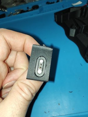

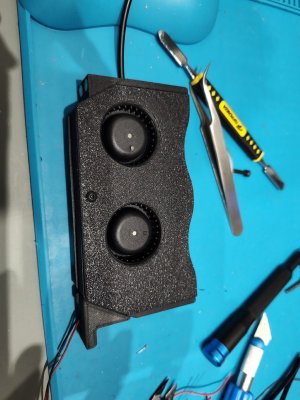

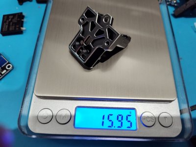

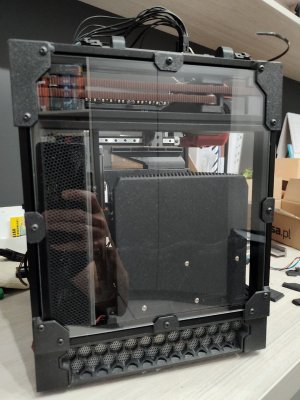

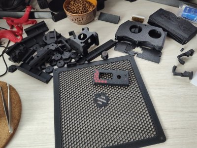

Further work. Unfortunately in the v0 there’s no space behind the toolhead for a Beacon, a Cartographer, or even a shaved‑down Eddy… For now it’ll run without a probe, and we’ll see in the future.

Almost done!

things that need fixing/rethinking:
  • add a rear cover for the electronics — I ran out of filament :D
  • the BTT SFS should be placed before the extruder, not after :D
