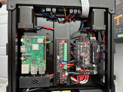

Cable duct for Voron V0.1 that houses the Klipper Expander.
Klipper Expander allows you to add additional functionality to your V0 / V0.1 when using an SKR Mini or SKR Pio board.
I'm currently using it for another NeoPixel plug and a thermistor for the chamber.
It's mounted to the rear panel using VHB
The Expander is held in place with 2x M3 bolts
Lid is held to the base with 4x M3 bolts
You'll need 6x Voron standard Heated Inserts M3 x D5 x L4
I've printed in Prusament ASA using Stock Voron Settings, can't imagine it needs to be ABS though as it doesn't get hot.
Model is 160mm x 40mm
Klipper Expander by Timmit99
https://github.com/VoronDesign/Voron-Hardware/tree/master/Klipper_Expander
Ali Express Klipper Expander
https://www.aliexpress.com/item/1005002384419036.html?spm=a2g0o.order_list.0.0.33c418023Fiy84
M3 Inserts
https://www.aliexpress.com/item/4000232858343.html?spm=a2g0o.order_list.0.0.33c418023Fiy84
The rear panel that covers only the top of the printer to keep the enclosure sealed is here:
https://www.printables.com/model/301882-voron-v01-enclosure-rear-cover-top-only
Don't forget to help a guy out and post your makes (and you serial number). V0.1848 here
