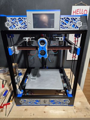

I like the look of the DOOM printers but didn't need the extra panels. So this is my take on a Doomish trident with the following specs.
Converted 1.8 frame
Duet mini 5+ with a 1LC tool board
5" Paneldue display
Rama idlers
Whoppingpochard kinematic mount
Split electronics (mains on bottom control's up top)
Belted Z with R3D electronic brakes
Stealthburner with Tap
Nevermore MAX
Umbilical running to the top electronics bay
Custom upper and lower skirts
I know I'm forgetting something but it has the build has changed since the CAD work was done

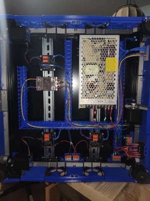

Wiring just about done. Ordered some PCB's to wire the cooling fans in parallel. Still need to get a power supply to run the numerous LED's that are planed. Haven't decided on how to control said LED's yet.

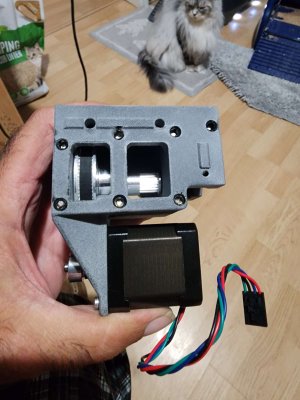

So with the brakes out, working on a different geared design. Once it is up and running for a bit to make sure everything is working as it should I'll put the cad file up on github. With the nice weather it is just a little slow with the updates
dang! thats a bummer... looks like you are sorting it out! i am using planatery nemas for my build they are pretty slick!
