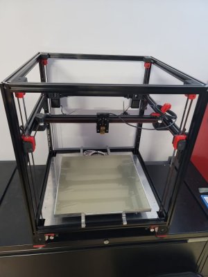

Here is a sectional of what I had in mind. The bottom of the build plate will have a cavity for the heater pad. I will then "Cap" it with a thin metal plate. The cavity will have some insulation inside it to keep the heat moving up into the plate and not down towards the electronics.
For increasing the chamber temps I could add heat fins to the sides of the plate maybe? :unsure:

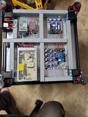

What considerations have you taken into place to prevent the thermal fuse from popping?
As for why everyone is mentioning bed fans and the like - it's a simple and effective way to increase your chamber/enclosure temperatures, which is something that ABS tends to like for stronger printed parts. Transfer of heat to the electronics bay in the stock design is relatively minimal, first due to the air gap between the bed and the deck plate, the deck plate itself, and then there's the two fans regularly pushing fresh air through the electronics bay.

I'm planning to mount the fuse on the outside in the usual place. If the plate gets too hot it should work as expected I would think.

Are you aware that by milling out a structure you induce stress into your plate. Might get some warping over time.
Yeah, I thought of that. I'm monitoring it and so far it seems to be stable. But if it warps I can always get another and try again. The main reason I thought to mill it out a bit is because its twice as thick as needed and it could take a long time to heat up. I figured taking some mass out will help the heat up times and since I got it out of the cutoff section it was really cheap and worth a shot.

That does look nice. Lucked out finding that piece in the scrap.
Who knows maybe the raised edge will make it more rigid and help keep it straight.
Kinda surprised you didn't machine spots for small magnets into the bed,... something I saw on BIB's utube channel.
